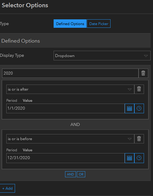

Without a "year" field, this can be fairly tedious, but it's possible.
Without Adding a Field
  1. Create a Date Selector
  2. Set Type to Defined Options
  3. Add an option YYYY with two criteria
    1. "is or is after", choose Value, 1/1/YYYY
    2. "is or is before", choose Value, 12/31/YYYY
  4. Repeat for as many years as you have
If your dataset has lots of years, this is a very unappealing option. Add to it the fact that you can't reorder the choices, so you'd better do them in ascending order, or future years will be at the bottom of the list out of sequence.
Oh and lastly. I don't know if it'll let you, but do not name your field "year", as that can mess up some internal stuff, it being a "reserved keyword".
However you do it, with a specific field corresponding to the year, you simply create a Category Selector, select Grouped Values, then choose your year field as the Category Field. Then your selector will auto-populated with new values as submissions come in.
