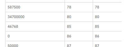

I can't account for the different totals you're getting in your FeatureSets, but I did dig into why the FeatureSet has different outputs. Take a look here at the output, and you'll see that the ID columns (I added the variable i as an integer field for testing) skip some values. What's going on here?

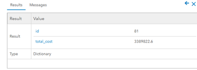

We can see that 81-84 are missing, so I'll call up a few of them from feat_arr to see what their values are.
The culprit: floating point values. I didn't anticipate these based on a quick sample of the input data, but odds are when it hits those floats and tries inserting them into our defined integer field, it errors out and skips.
100% solutions (pick one):
  1. Round off the values before inserting them into the array, i.e., Round(a.TOT_PRJ_CO)
  2. Change the field to a floating point type
I like integers myself, so here's the output with a rounding function in the loop.
Again, I'm still not sure why your FeatureSets are reading out a different total. I even get the correct totals when including the additional fields.

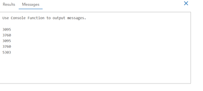

Hello, as it turned out the solution appears not to be 100% correct and I am at a loss to figure out why.
It seems that each array contains less features that the source featureclass and  the combined set has still fewer features.
For example, I have 3197 points.  immediately after created the 'featureDataPoint is shows 3095 -- as reported via a console message using the count() function.
The total number of the two layers combined starts at 7011 and in the arrays are 6855 and in the final "newSet" is 5303
Here is my current code:

Console messages showing the counts.

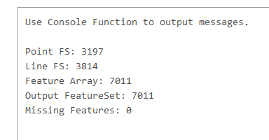

Well, this is certainly strange. When I add console messages to my own expression, it returns the correct totals for the FeatureSets and layers, but the FeatureSet at the end is smaller.

Once again, you came to the rescue!  The code is now working 100% I believe.
We are in fact getting the correct record count.  It was my error thinking we were not.  The issue was that we have been trying to access a server that is super slow and intermittent.  I had copied the data to our AGO, but it was an older version because the other site is SO slow I would not even download both files yesterday.  The difference in the files account for the apparent different count.
