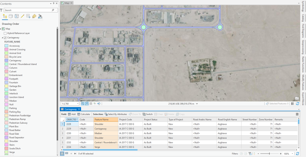

Using ArcGIS Dashboard I am trying to show the progress of road and infrastructure , completed and the uncompleted work, but I still do not know how to prepare the attribute table and the map for that, any suggestion please.Road.PNG

Just add a new field "STATUS", with values 'Completed' and 'Not Completed. This field could be used in Filters, Statistics or Symbology in a Dashboard, as required.
