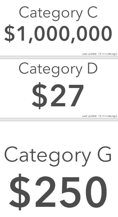

Here is a portion of the dashboard:
dashboard
How would I configure a widget to give me the sum of category c, d and g?

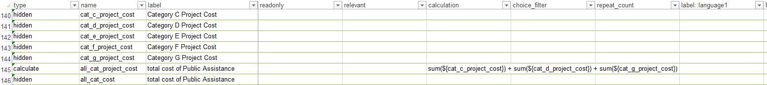

My thought was to calculate it within Survey123. That's what the all_cat_project_cost on lin 145 is. The formula within Survey123 appears to work. However, when I try to get the data to appear in the Dashboard, I can see there are four entries (my test entries) but it will not give me the sum of the values... merely the sum of the number of entries.

Is there something wrong with my calculation within Survey123 on line 145?
StephenM
The calculation looks good. I think the issue is that the calculation doesn't like null values. If you set a default for the category fields it should work.
