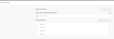

DarrylKlassen1
@EllieLinden within the serial chart - when you first open it - you can select a layer form a map item or you can create a data expression which will allow you to create a new feature set "on the fly" without having to change the underlying data.
https://doc.arcgis.com/en/dashboards/latest/get-started/create-data-expressions.htm
EllieLinden
@DarrylKlassen1 I see, thanks for clarifying - I hadn't tried that yet but will take a look, thank you!
