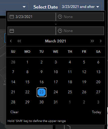

Hello, this is what happened to me too. I had a dashboard created few months ago and the clients are using it regularly. I opened the dashboard for editing today and found out the date selector has changed. I can no longer able to pick a date, the date show two range but just one of respond to the date selection, even if I click on the lower date and select a date from the calendar, the date gets changed on the upper date window. see the below snapshots. this tool is crucial to our client day to day work. any help is much appreciated.
Only the highlighted date respond to the calendar's date selection
And using the Shift key to select the upper date range is not working? First click the start date and then hold the shift key and click the end date. Then you can click outside the calendar to dismiss it when finished with the selection.
Thanks heaps Sandra, I wasn't aware of the shift key thingy, I guess this is a new configuration to the date selector.
it is working like a charm now!!! thank you

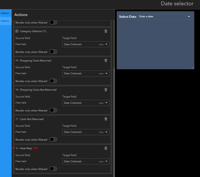

Hi @SandraLuken1, we noticed that one of the layers (Heat Map) does not change when we select a date range. The layer is included in the date selector actions section. Do you have any tips on how to fix this?
This is a known issue with ArcGIS Dashboards, and other JSAPI 4x based applications. This will continue to work with ArcGIS Dashboards Classic (found in the app launder). You can contact Technical Support to be added to the bug and be notified when it is fixed.
