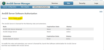

FelipeDias
According to this page, the bug was fixed on version 10.2. However, even though my Dashboard is hosted on an Enterprise Server that's been updated to version is 10.9.1 (see image below), the bug still persists! Does anyone have an idea of why this is happening?
EricKriener
because the bug happened in 10.9 and isn't fixed until 11?
Look at the dates in your link...not sure who put the versions in, but they had more than a three martini lunch.
Version found should prob be 10.9.1
arc_ticodex
Hi @FelipeDias and @EricKriener!
That's right! The version found should be 10.9.1 and fixed 11.
My Enterprise is 1.9.1 and the bug is still on, but in my ArcGIS Online it's fixed!
