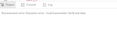

The only error I'm getting currently is "Invalid variable assignment". It's flagging the first GroupBy(,  there are no other known errors.

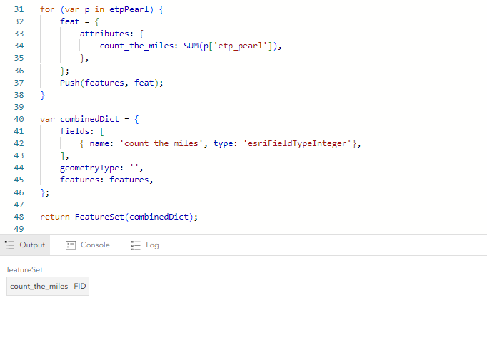

It's no longer erroring out, but I'm still not summing fields yet, but at least I can save it now. I'll update as soon as I have some results. Much appreciation for spotting that error on my part!

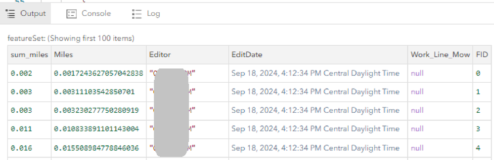

Update: 10/10/24 This is what it's creating.
AlexPage
Making progress. I've got data coming into the table now. The next step is figuring out the null in the Work_Line field. This is a domain of about 7 choices. Since the output is a text string I wouldn't think it needs a dictionary would it? Oh and the SUM function doesn't seem to be working yet, but at least it's showing something : D
I checked for nulls and there are none. I've been over and over the syntax, not seeing any typos.

Can you supply screen shots of the two grouped FeatureSets?
AlexPage
This is all that it's outputting. Here's the way it's coming into a serial chart, keep in mind I'm just doing something with the data to see what's accessible. This is giving me the miles by field Editor, not what I want, just playing with it.

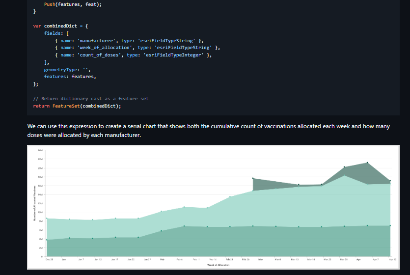

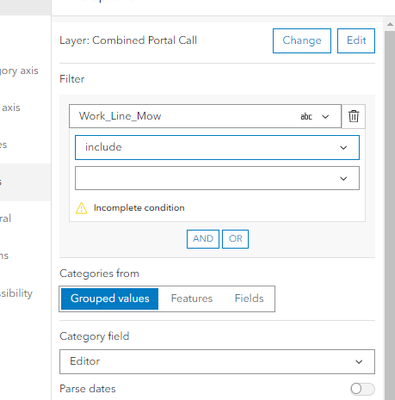

What I'm doing ultimately is calling 20-40 of these same layers from different projects, filtering by the Work_Line_Mow field (below) so that it only includes finished work. I was just trying to use the built in filter, but you can see in the screen shot it said incomplete condition, and it won't pull in the fields, this was surprising because I thought I'd mimicked the other syntax perfectly.
This is my flow logic, it should ingest the featuresets, filter the features in this layer by the status, then sort the remaining features by week using the EditDate, then sum each week in the Miles field.
So the Category axis is the layer/project, and the Value axis is the week this summed production was completed in.
So that it's like this vaccines per week per vendor chart. Very similar result, I'm just having a hard time duplicating this.

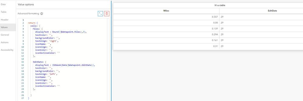

Here's the table I had using nearly the same format of script, but I can't seem to use $feature or $datapoint with the virtual data.
Maybe I'm going in the wrong direction, but I keep think I've got to get the data filtered by the status field and then sliced by week.
