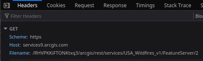

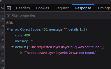

Try running the script with your browser's developer tools open and watch the network tab.
The response to the query will often have more information in the event that the expression is not successful.
Do you get anything useful from that?

ARose615
This helped greatly!  Looks like there is some networking shenanigans that I can trace down now. Thank you!
