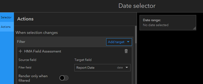

That is possible. To go step by step, choose the date selector element, then from Action choose add target and choose any element(indicator, map or any other element which exists within the same dashboard).  all the layers you add must have a reference date field and choose that. So you are done!
Such as this:

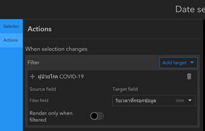

Such as this:
