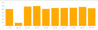

I know I've made a histogram in Arcade in the past, but I can't find my original code. So, we want to group our features into bins, and have these bins show up in a bar chart.
Your expression is pretty close already, but we run into trouble: without a numeric bin number, the bins have to sort by their name, which isn't always right.

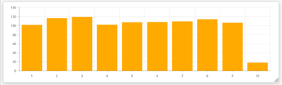

I figured out how to include a "bin number" attribute, but when the chart groups by that value, we lose the ability to show the "bin name", the range of values, as the label.

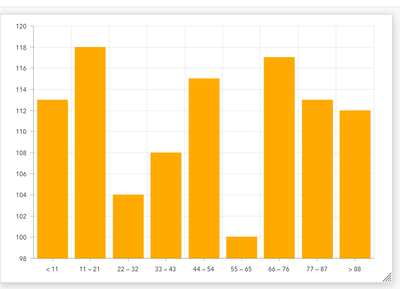

So, the best way to do this is to group the values in the expression. I tried it with the function GroupBy. That way each bin is its own feature, and we can set our chart to be based on features, rather than grouped values. But that brought its own trouble. Suppose one of your bins were empty? The chart omits it!
Here's the same histogram, but with values removed from one of the bins. Rather than showing 55 - 66 as an empty bin, it's removed from the chart entirely, which could lead to very misleading histograms.

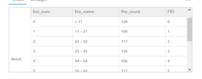

It isn't perfect, sometimes depending on the bin size and min/max values the bin count might be off. But the resulting featureset is good:
To use this, just drop that function into your script and after you define your featureset, call Histogram(fs, 'VAR27', 10).

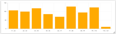

You can mess with the bin size as you like. I suppose you could hard-code min/max values into the expression, too, but I wanted something that could adjust to the input data.
Once you have it, set your chart to "Features", wtih "bin_name" as the category, "the_count" as the series, and sort by "bin_num" just to ensure that the bars show in the proper order.

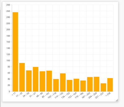

You may wish to set the chart's min value to 0, otherwise the histogram could be misleading. Here's the function with 15 bins and a different set of numeric data.
