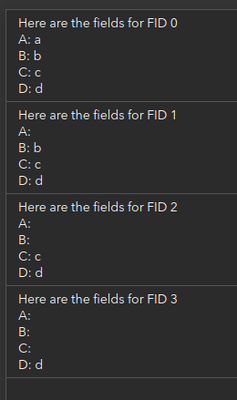

When an attribute occupies a single line of your line item template, nulls are genuinely skipped.
The trouble is that you're preceding your attributes with text, so that text will always show up. In order to get that text to be dynamic as well, it needs to be driven by an expression. You can do this with the advanced formatting.
I'll change my example to include additional text:
In general, you want an expression that returns the label and the value if there is one, but nothing if there isn't. That could look like this:

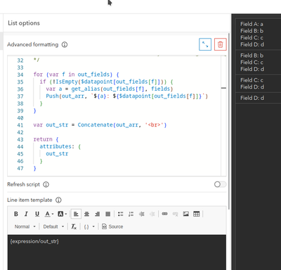

var text_A = iif(IsEmpty($datapoint['A']), '', `Field A: ${$datapoint['A']}`)
Then have your line item consist of things like {expression/text_A} instead of directly accessing the fields. But re-typing all that for each field could be annoying and tedious, especially if it's a long list of fields.
Here's a more advanced method that could apply to a list of fields as long as you want, and will handle the building of the string and pulls in the field alias.
// get schema
var fields = Schema($datapoint)['fields']
// empty array for our output string
var out_arr = []
// list field names that we want in the output text
var out_fields = [
  'A',
  'B',
  'C',
  'D'
// function for returning alias
function get_alias(fieldname, fields) {
  for (var f in fields) {
    if (fields[f]['name'] == fieldname) {
      return fields[f]['alias']
for each field in that list, we will
1. check to see if the value is present
2. if present, grab the value and the field alias
3. add the two to our output array
after that, we'll concatenate that array into a single string
for (var f in out_fields) {
  if (!IsEmpty($datapoint[out_fields[f]])) {
    var a = get_alias(out_fields[f], fields)
    Push(out_arr, `${a}: ${$datapoint[out_fields[f]]}`)
var out_str = Concatenate(out_arr, '<br>')
return {
  attributes: {
    out_str
And by entering {expression/out_str} in my list item template, I get this:
- Josh Carlson
