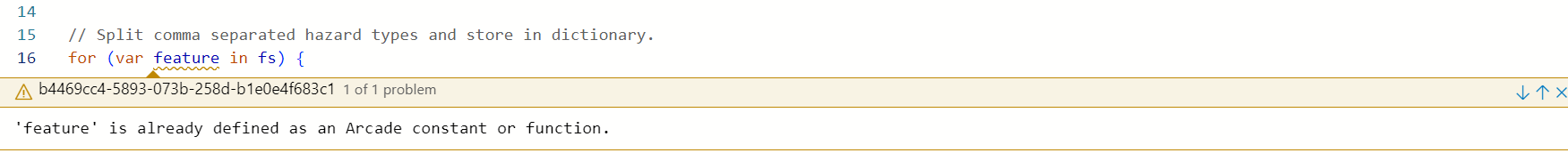

Error in New Expression using Arcade - (var feature in fs) - feature already defined

However when I run the expression, it returns the following error
Could anyone help me in fixing it knowing that I don't know anything about arcade.

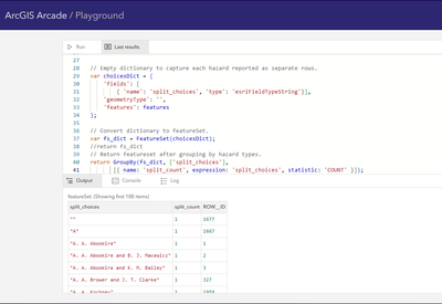

The code does work substituting my own portal item. Where is it breaking for you? Are you checking the output at various places in the code with Console to see if it's returning what you're expecting?
var p = Portal("https://noaa.maps.arcgis.com/");
var fs = FeatureSetByPortalItem(
    p,
    '1624f1a86dca4af086cc13141a1b0e2b',
    1,
    ['Authors'],
    false
// Create empty array for features and feat object
var features = [];
var feat;
// Split comma separated hazard types and store in dictionary.
for (var feature in fs) {
    var split_array  =  Split(feature["Authors"], ',')
    var count_arr = Count(split_array)
    console(count_arr)
    for(var i = 0; i < count_arr; i++ ){
        feat = {
            'attributes': {
                'split_choices': Trim(split_array[i])
        Push(features, feat);
// Empty dictionary to capture each hazard reported as separate rows.
var choicesDict = {
    'fields': [
        { 'name': 'split_choices', 'type': 'esriFieldTypeString'}],
    'geometryType': '',
    'features': features
// Convert dictionary to featureSet.
var fs_dict = FeatureSet(choicesDict);
//return fs_dict
// Return featureset after grouping by hazard types.
return GroupBy(fs_dict, ['split_choices'],
       [{ name: 'split_count', expression: 'split_choices', statistic: 'COUNT' }]);

KenBuja
MVP Esteemed Contributor
That's not an error, but a warning. You shouldn't use reserved words as variable names. It will still work, but it might cause problems.
mfreeman
Thank you for your response.
Unfortunately it then don't allow me to progress further and select the expression to build my chart
    p,
    1,
    ['Authors'],
    false
var features = [];
var feat;
    console(count_arr)
        feat = {
            'attributes': {
var choicesDict = {
    'fields': [
    'geometryType': '',
//return fs_dict
