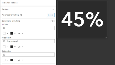

The Indicator widget, though, is going to aggregate your data, unless of course you have it set to show an indcator per-feature. For instance, here's an Indicator of a "world cities" layer. I have the value set to a sum of "MALES", and the reference set to a sum of "POPULATION".
With my value and reference set, I can have the indicator set to "{percentage}". No advanced formatting or data expressions needed.

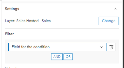

Once you have that, you can apply a filter to your indicator to only include features where Lovpercent is 49% or greater.
Then configure the indicator to use the M3SK_HA_Lov attribute as the value and M3SK_HA as the reference value, both set to Statistic: Sum, and have the indicator show the percentage.
