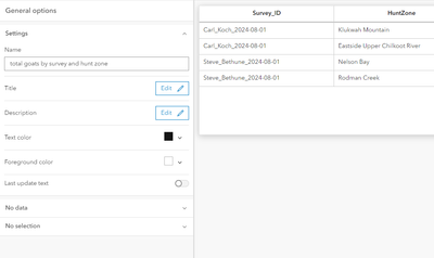

I want users to be able to download summary tables from a dashboard (I am just learning AGOL and dashboards). I created these summary tables of AGOL feature layers with Arcade code.
The instructions here https://doc.arcgis.com/en/dashboards/latest/create-and-share/download-data.htm say:
But I don't see any mention of download options within the 'general' tab:
Nor is there a download arrow at the bottom of the element as described in the instructions on the page.

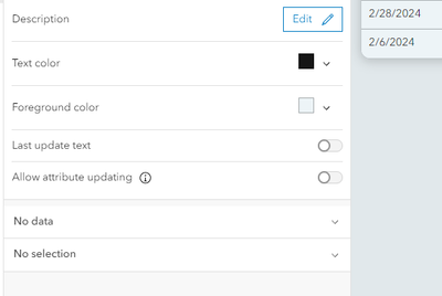

I believe that something changed in the most recent update to ArcGIS Online.  I used to be able to configure a table to allow source data download.  It was a simple toggle switch
This is a table that I have in a dashboard.  This was created earlier this year.
Today, if I add a new table, the Summarized data download option does not appear.  In its place is Allow attribute updating (which is great in general, but if the data was originally created in Field Maps with expressions to calculate data, i.e., pull the nearest address based on the parcel layer, the edit function in the dashboard cannot process that it seems and those fields become blank, even if I don't choose to update them.  I realize that is an issue for another post)
I encountered this yesterday when i went to try to create a table where an end-user could download the source data to a csv file.  This functionality does not appear to exist in Dashboards anymore.

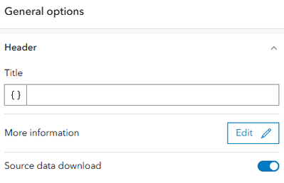

I see the option has changed. It is still in the General options just below the Title, but it is not working. Has anyone figured this one out? Thanks.

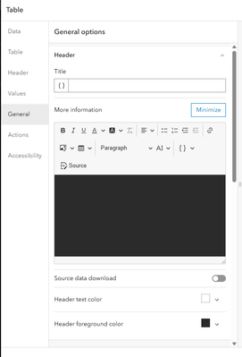

Hey Dave,
A year late but I was having the same problem as you. I found the option to allow export once I expanded the more information on the header. I was able to find the Source Data Download when I expanded that item. Hopefully you found this solution.
