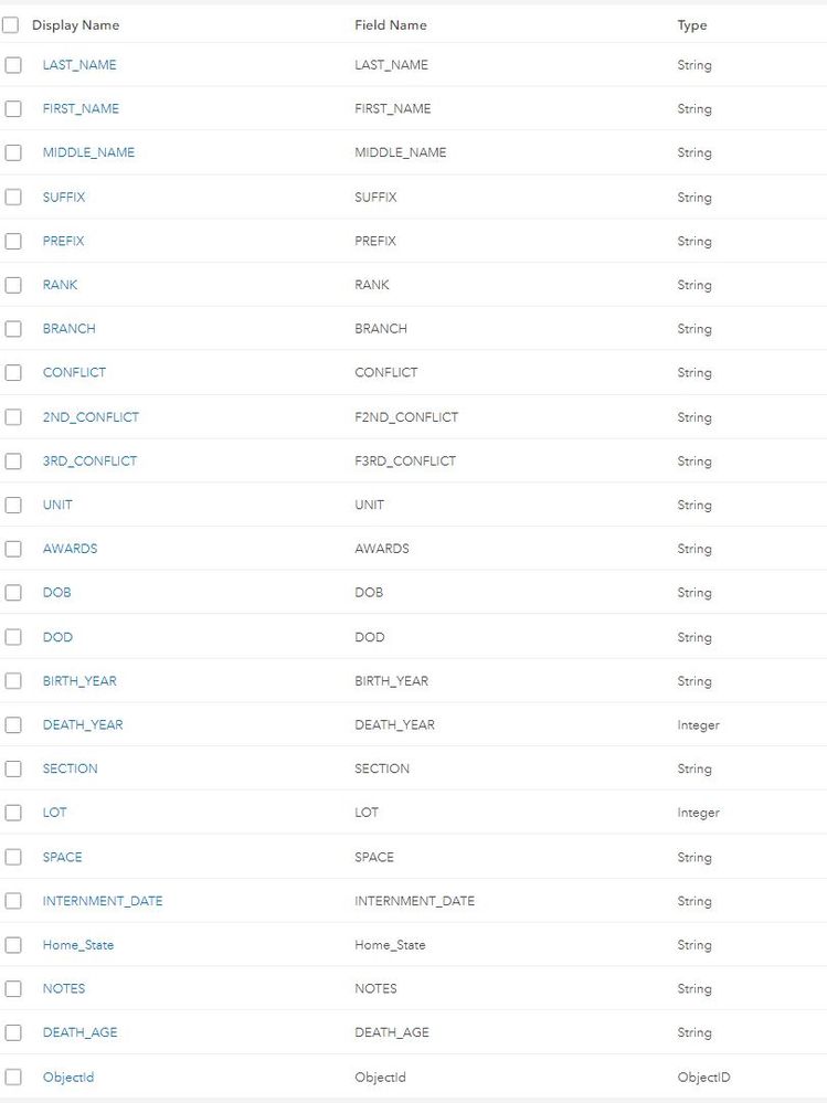

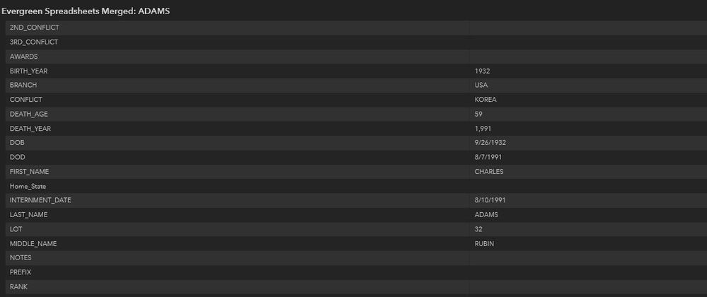

Hello. I am making a dashboard for my work for displaying veteran burial information for several cemeteries in our city. All of the data has been categorized and filtered in a way I wish to display it within the spreadsheet/csv that I uploaded to ArcGIS online. However, when I select the layer for the data within my dashboard and view it as a details page in the dashboard the order of the data is by display name, not the table order. I cannot find any way to change the order of how the data is seen within the details page. Can anyone help me? is this possible?
The first picture is how my data is displayed in the dashboard and the second picture is the order I want it to be in (in its table order).

Hello there, yeah it is definitely an issue. The way I was able to work around it was to import the table into Arcgis Pro and then share the table directly from there to Arcgis Online and access it that way. It seems to work most of the time but I have had a few occasions today that I had to delete the table that I had just uploaded and re-upload it all over again for it to load in the order of the table. Hopefully you can get it to work!
