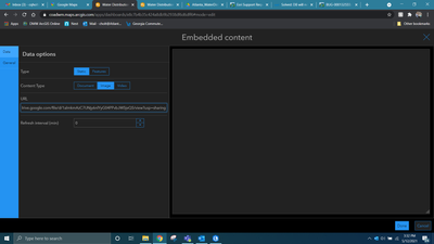

I am having same issue, but when I attempt to embed a jpg the screen in blank. What was your solution?

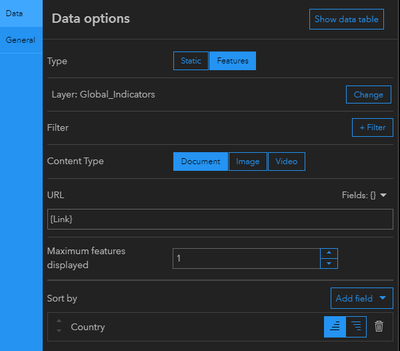

These are the steps we took:
  • we host the jpgs on our server so they have a url
  • we created a field called "link" in the data layer and added the jpg urls to that field
  • when configuring the embedded element, we pointed it at that link field
Hope this makes sense/helps!
