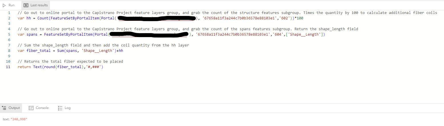

I have a dashboard where I am inserting an indicator. My indicator is looking at a layer and is working fine. I want to edit my reference layer to combine some data from two different layers. I am using the data expression option to create some arcade code to return the value that I want. I have gotten it to work in the arcade editor, but when I save the code and try to make it my reference layer it says "Unable to execute Arcade Script."
The layers that I am trying to reference are part of a layer group. But it seems to work fine when it is in the editor and grabs the right data.
Any ideas on what I can try?
