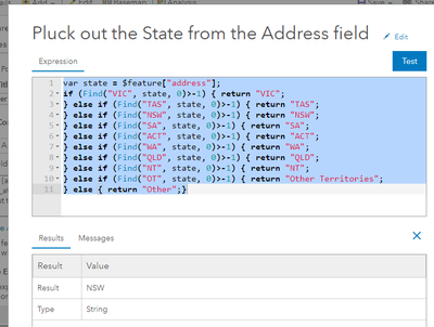

With arcade in a popup, I am familiar with how to pluck out the State abbreviation from the address field:
I have been struggling to try and build a Data Expression in ArcGIS dashboards to achieve this.

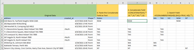

The following is probably not the most efficient way to do this, but it wouldn't take too long anyway.
  1. Copy your data into a new workbook just in case
  2. Write a list of your States across the columns (H-L, in my example)
    1. =IF(ISNUMBER(FIND(H$2,$A3))=TRUE, H$2,"")
      (Change cell references as necessary)
    2. Drag that down the column, and across so that each of your states has this formula underneath it. (Or Select Cells, Ctrl+D, Ctrl+R)
    3. This will search the address field for the (Case-sensitive) State abbreviation and return it if present, or else a blank.
      1. You can set it up to return the full name if you want. Replace the second H$2 with "Western Australia", for example
  3. In another column (F, in my example)
    1. =CONCATENATE(H3,"",I3,"",J3,"",K3,"",L3)
    2. Drag that down the column (or Ctrl+D with the column selected).
    3. This will collect all of the states from your search columns into one column
  4. Copy your Concatenated Data Column and Paste as Values Only into the States Field of your original data

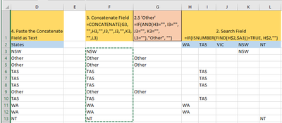

If you want an "Other" Value for where no state information is entered into the original address
  1. In Column G,
    1. =IF(AND(H3="", I3="", J3="", K3="", L3=""),"Other", "")
      (Change cells as necessary)
    2. Drag down the column
    3. This will input the value of "Other" if the address has none of the States listed.
  2. Add  G4,""
    to your concatenate formula, drag down the column, copy and paste as values in the State field.AlfredBaldenweck_1-1627427138980.png
I probably over-explained here, but this is a pretty fast (like 5 minutes max of set-up time) way to extract that state information out of data you already have.
