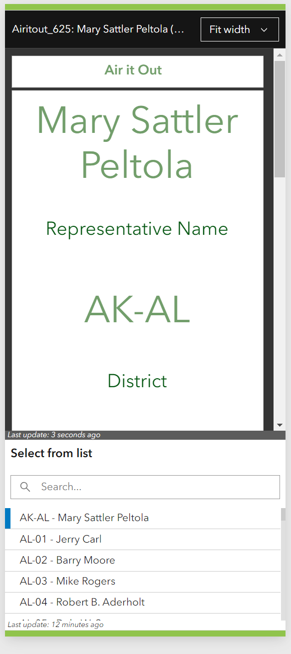

Hi all, I have designed a dashboard that generates an infographic and created a mobile version for it. In the editor mode on desktop, the mobile view shows up with a scroll bar to view the full infographic (see below, screenshot from a desktop device of a preview of mobile view).

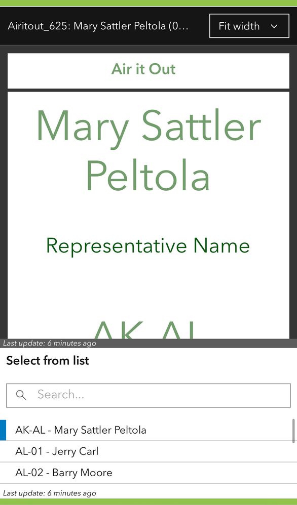

But when viewing the dashboard on an actual mobile device, the dashboard does not have any way to scroll or view the full infographic. Here is a screenshot from a phone.
How can I configure a scroll on actual mobile devices, the way it looks in the mobile preview on a desktop?

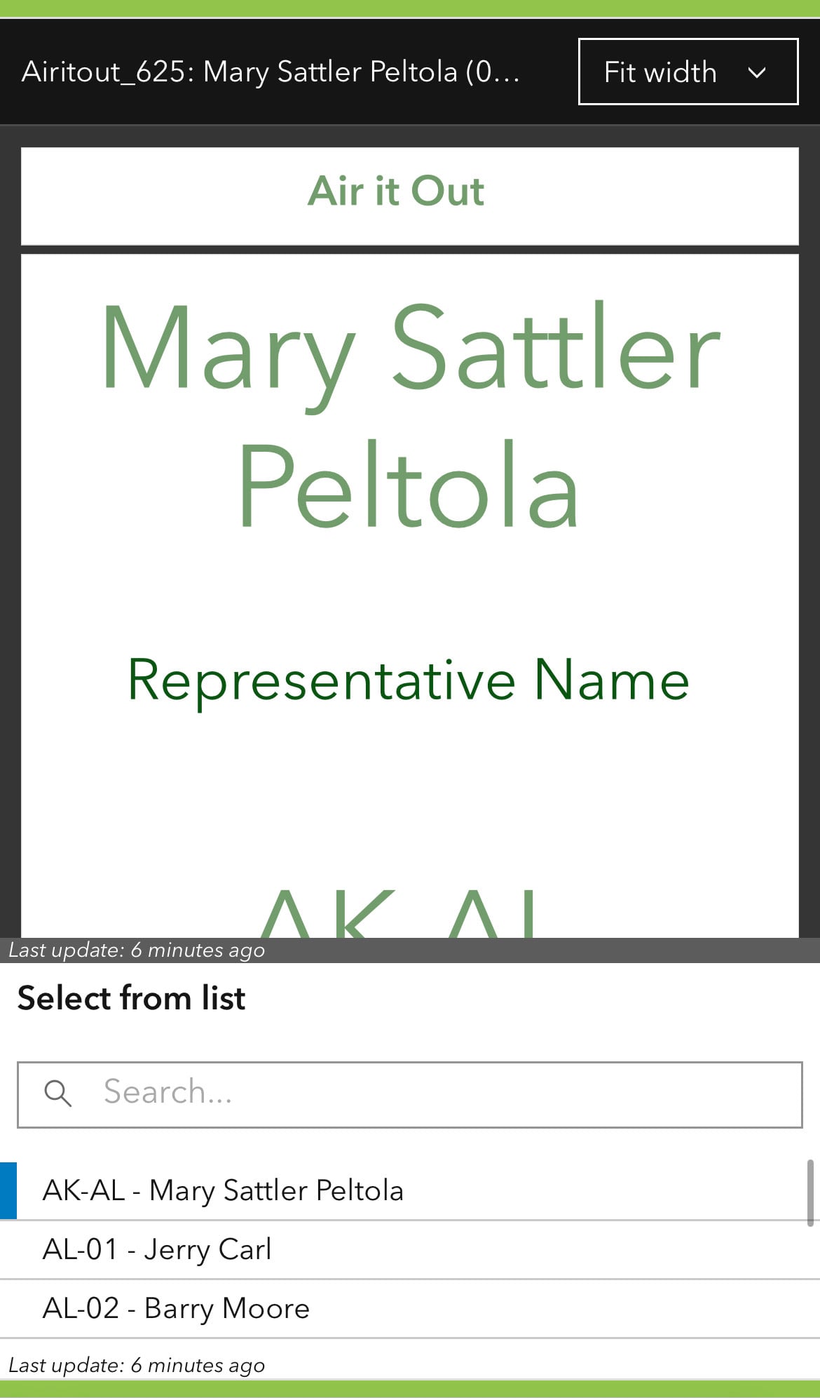

Did you get this figured out.  I'm noticing the same thing in a list a created in the Mobile version of ArcGIS Online Dashboards.  My issue is more it has the scrolling capabilities and it starts to scroll, but it automatically bumps the list back to the top after I get to the end of the first item in my list, so I can never get past the first item in the list.

This is the update I received on 10/24/24 on the Bug that I submitted.
BUG-000169826 - Lists scroll back to the top in ArcGIS Dashboards when viewed on Android devices in mobile view.
Status: Under Consideration
Additional Information:  Thank you for reporting this issue. We\'ve accepted the bug and are exploring solutions. No timeline set as of yet.
Alternate Solution:
Increase the vertical size of the list element and, if possible, toggle off the search function. This should avoid the underlying issue.
