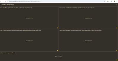

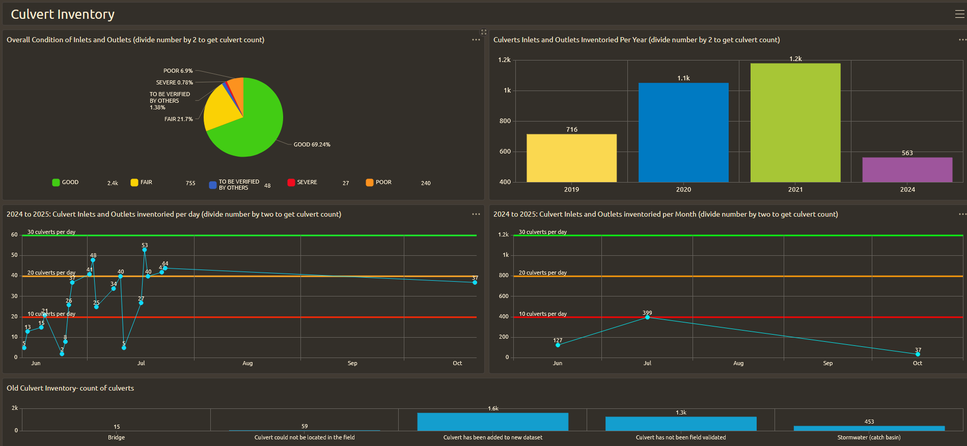

I created this dashboard, and shared it with our public works group:

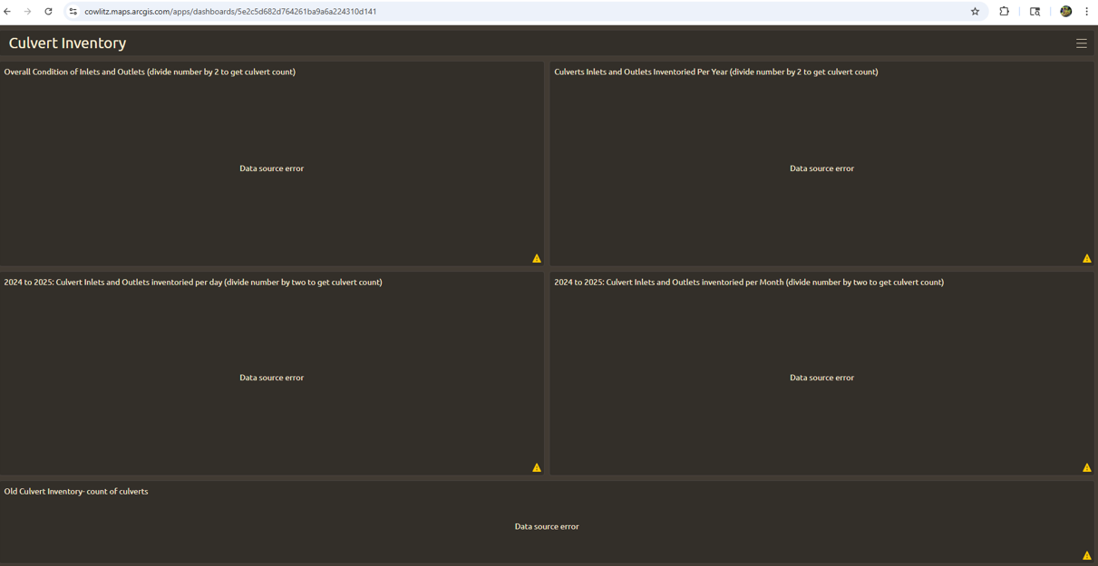

When my coworker who is in the public works group opens it he gets this data source error:
I confirmed that all of the layers and dashboard are shared with the public works group.
I just created the dashboard today and everything loads perfectly for me so it is difficult to troubleshoot the cause of the issues.

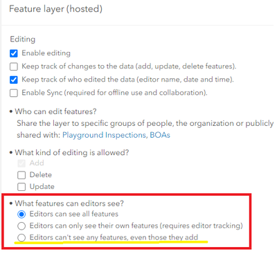

Hey @L77,
Sometimes settings in the Feature layer can cause that behavior.
It could have been also cached or network issues if you did not make any change during the "Lag time"

L77
@GlenterpriseUK
Thank you!
I checked the settings and they are the same as the screenshot that you shared.
