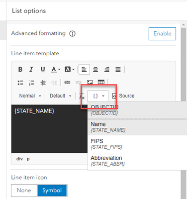

I do not see any screenshots, so I'm assuming there's nothing unusual happening...
You can use the curly brackets to select fields in your data to display, or if you know the field name you can simply type it directly into the text editor inside curly brackets {fieldname}. Simply delete the default field if you don't want to display it.
