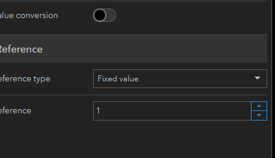

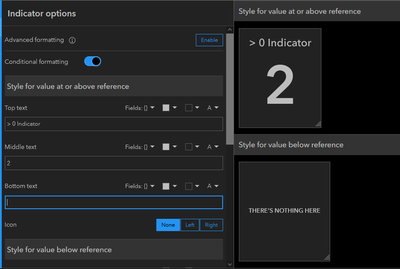

You can use conditional formatting, if all you want is something else to display when the count is 0.
Set a reference value of 1.
Then set the "below reference" style to whatever you want.
Now a count of 0 will display with whatever message you enter, rather than a 0.
