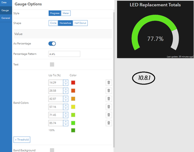

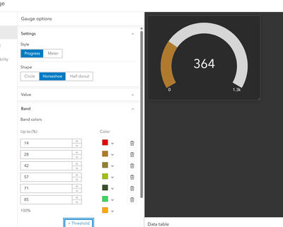

We recently made the move from Enterprise / Portal 10.8.1 to 11.3. I am currently getting all my applications configured to match our existing 10.8.1 applications. One dashboard I am working on has Gauges with preset bands to show progress. In the old portal, the band color seemed to be the dominant factor rather than the background color. I've gone over all the settings I know to look at but can't find a way to flip it and show the band color for the progress rather than the background color. Any ideas?

Interesting, I just tried in 11.2 and it worked as expected.
Have you tried remaking the gauge?
Can you check your max/min settings?
