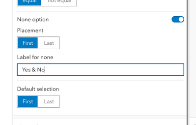

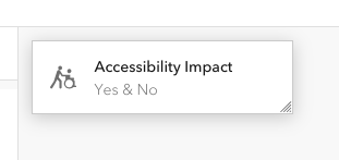

jcarlson
MVP Alum
When you configure a filter in a Dashboard, you can turn on the "None option". The label is a little misleading to me, it means "no filter", which is also "all data".
You can change the label as you like:

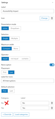

DanTrudgeon
Thanks Josh, appreciate it!
I had played around with the 'none' option, but it leaves me with three options because of the "Grouped Values" setting, avoiding my labels these would be, "Yes", "No", "Yes/No".
I tried deleting the "No" option below, but it does not seem to change anything on the dashboard.
I also tried changing to "Defined Values" and only populating a "Yes" option.

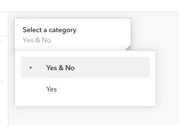

You can have a "None" option on a Defined Values selector, too.

DanTrudgeon
Perfect, that was my missing piece. Thank you!
