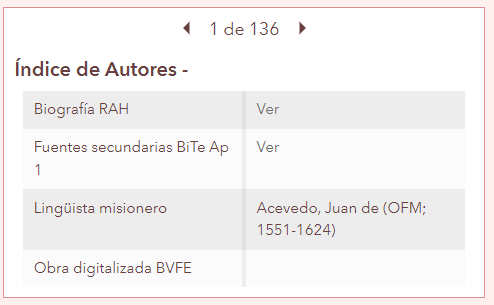

I have a Detail panel (consisting of an Excel sheet), sorted by alphabetical order. I want the order to be different but I can't find the way. Even the Excel file and the allocated table are sorted correctly.
This is the Details Pane

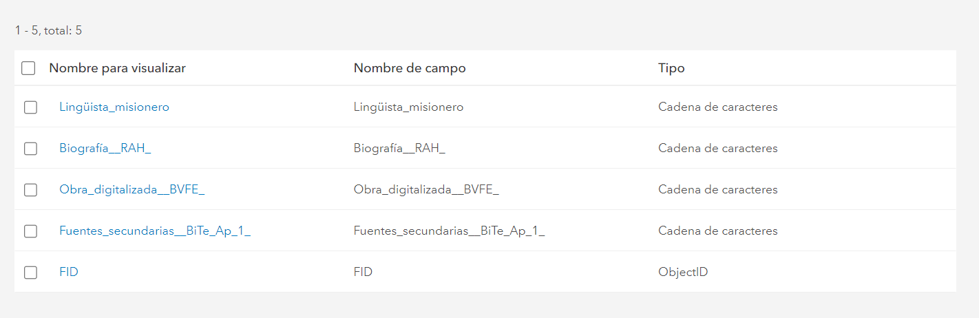

This is the File on Arcgis Online

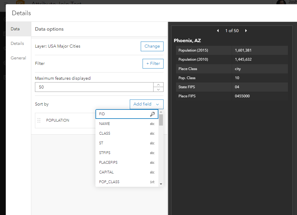

You can configure the sort order directly in the widget settings, even having a multi-field sort:
- Josh Carlson
Kendall County GIS
MinervaCPeña
Thanks, Josh, but I mean the order of the fields, which in the Details Panel is in alphabetical order, and I want it as in the Excel File

MinervaCPeña
So how can I change the visualization settings? It's an Excel File, and its columns are in the correct order. Here I attach the URL if this helps: https://services7.arcgis.com/4WPJ1i5JxoiTWeX7/arcgis/rest/services/I%CC%81ndice_de_Autores/FeatureSe...
jcarlson
MVP Alum
Go to arcgis.com/home/item.html?id=bcba98b9a36e479f9744934ed6cf1cf8 and look for the visualization tab there.
