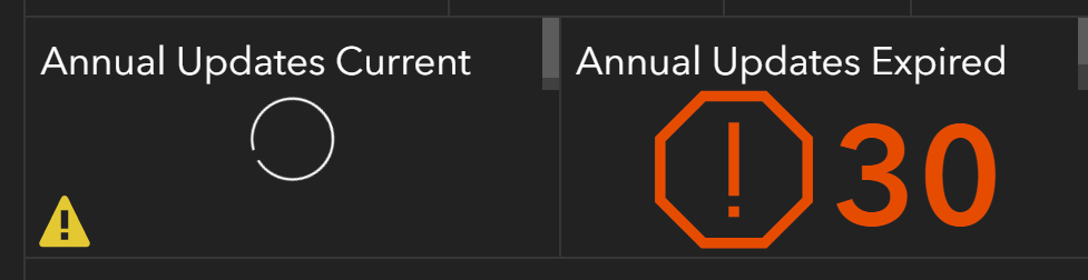

Today, after Dashboard Beta moved out of Beta, Dashboard components cannot access a data source (a hosted feature layer view) when the query is: 'Date is within the last 365 days'.  Querying 'Is before the Last 365 days' loads fine. See screen cap:
Prior to today, the query worked fine. The issue occurs in both Dashboards (previously Beta) and Dashboards Classic.

I am having the same problem with several dashboards with unrelated data. I have tried making new ones using Dashboards and Dashboards Classic using both the new and classic map viewer and I get the same errors. The data are displaying on the maps, but the widgets aren't working like they used to a few hours ago.

Hey Jelle - as soon as I select Query is within by days, on a component the data table unloads. It definitely doesn't like that query parameter.

I am having similar issues in dashboard after the upgrade from yesterday, components shows can not access data. I've tried recreating components, issue is still presenting.

The problem seems to be a new rate limit that has been implemented with the update. Following these best practices may help https://doc.arcgis.com/en/dashboards/reference/build-highly-scalable-dashboards.htm
Unfortunately, I still think it is going to be a problem for a lot of us.

Thank you @Andrew_Purdon This is a bummer, I see they don't recommend using relative date filters in the new dashboard anymore. I wonder what are the alternatives out there.
