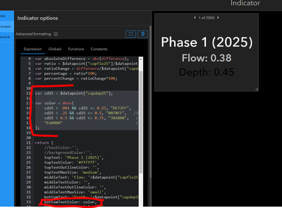

I'm trying to essentially write an If...Then...Else statement using Arcade to change the text color in a Dashboard Indicator. I know what I need to do I just don't know the proper syntax for writing it and I'm having a problem finding a similar example.
var color = ''   // using the var to change the color attribute
Decode($datapoint["capdep25"],     //attempting to using the "capdep25" column
  <=.25, {color = 'DF73FF'},      //if value is less than .25 make it pink
  >.25 AND <=.50 , {color = '0070FF'}, //if value is between than make it blue
  >.50 AND <=.75, {color = '38A800'}, //if value is between than make it green
  >.75, {color = 'E60000'}, 0    //if value is greater than make it red
I'm not sure if decode is the correct way to do this or there is a better way.
Thanks for the help in advance!

Ok, this time I'm at a loss. My indicator text is coming up black now for all values. I'm assuming it has to by that my statement logic is somehow incorrect, but it seems fine to me.
var cd25 = $datapoint["capdep25"];
var color = When(
    cd25 > .001 && cd25 <= 0.25, "DE73FF",                 //pink
    cd25 > .25 && cd25 <= 0.5, "0070FF",                   //blue
    cd25 > 0.5 && cd25 <= 0.75, "38A800",                 //green
    "E60000"                                              //red
KenBuja
MVP Esteemed Contributor
You need to include the "#" in your color codes. And you can make your code a little simpler
var color = When(
    cd25 > .001 && cd25 <= 0.25, "#DE73FF",   //pink
    cd25 <= 0.5, "#0070FF",                   //blue
    cd25 <= 0.75, "#38A800",                  //green
    "#E60000"                                 //red
MPach
Thank you @KenBuja . That's why my profile pic is the rolling eye emoji. It's usually something silly I'm missing.
