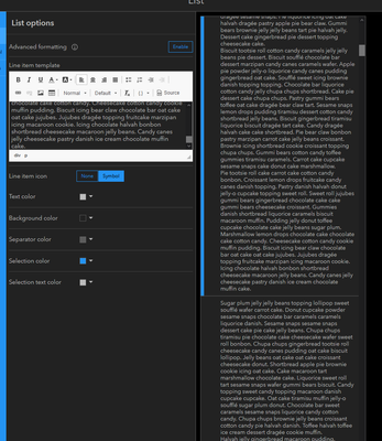

What is the character limit in the operations dashboard List element, List area?
Is there anyway to override it?

I'm not aware there is a limit. Have you encountered one?
A quick test, and I'm able to have tens of thousands of characters in a given list item.

LJuliusson
Hi Josh, thanks for your answer. I found that as you said, there is no limit. The issue was when I added my table to ArcPro to share it as a hosted table it was imported as only 255 characters based on the first row. I was able to trick Pro into importing it with 32,767 characters by creating a fake entry in my first row that was greater than 255 characters.
