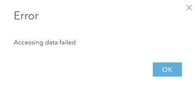

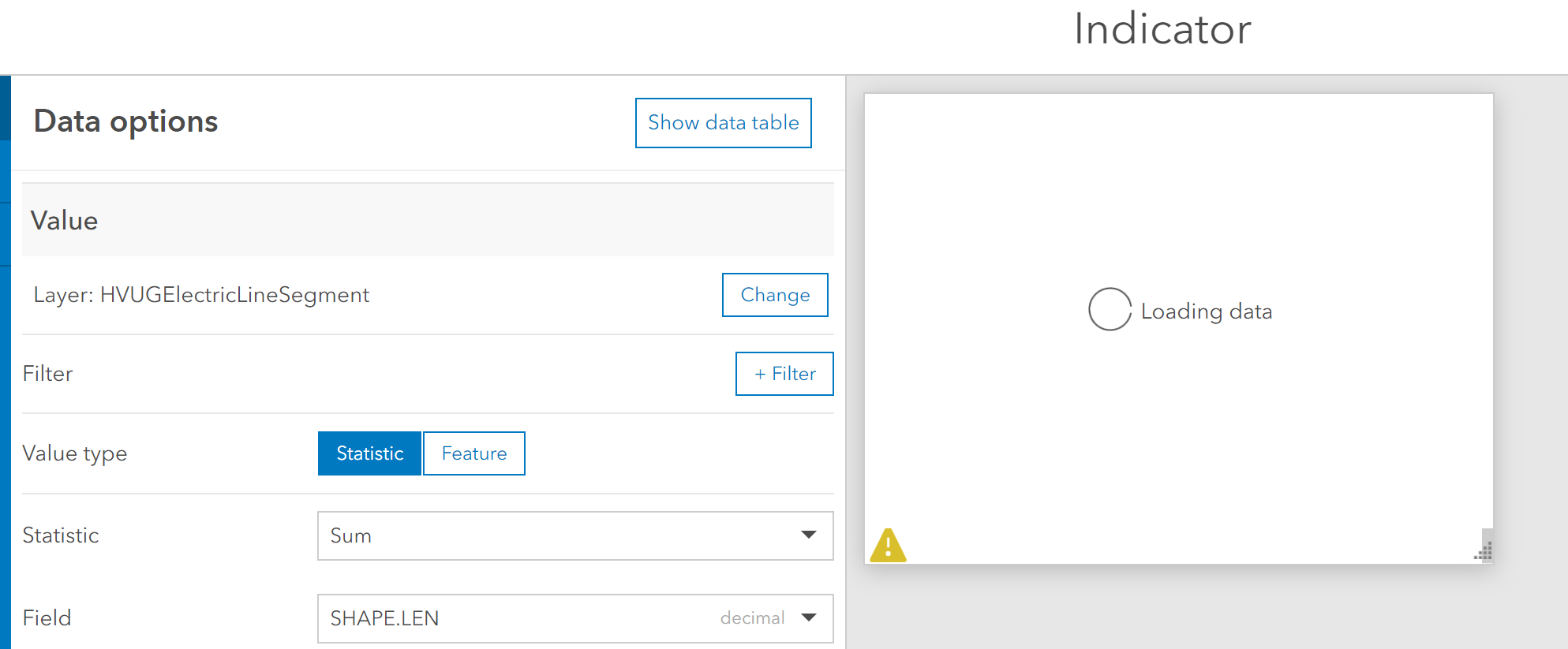

We’re facing an issue in ArcGIS Dashboards. When we tried to make statistics to get the sum of SHAPE.LEN of a linear assets the error “ Cannot Access Data” returned as shown in below snapshot:
Also, we try to get the statistics from the WebMap itself but the below error pop-up:
Please support us to figure out the root of the issue.
