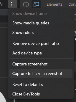

Hi Jansen, this might work for your purposes:
1. Open the dashboard in Chrome/Edge and press CTRL-SHIFT-I to open developer tools.
2. Press CTRL-SHIFT-M to toggle on device emulation.
3. Make sure Dimensions: Responsive is selected at the top of the window, then enter an appropriate resolution. 3000x2000 seems to give a good resolution for a 36x24, but you can experiment.
4. Select DPR: 3.0:
5. Click the three dots and select Capture Full Size Screenshot:
Wait a few moments and Chrome/Edge will create a PNG in your downloads.
JRhodes
4. Select DPR: 3.0:
