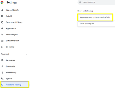

Okay, I got this figured out...I ended up going into Chrome settings and resetting/restoring Chrome to original defaults (which cleared cache, cookies, and probably other things), and then everything in the Dashboard is working again. I guess something got wonky in my local instance of Chrome.

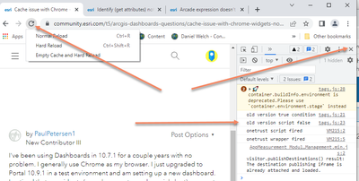

Other than clearing the cache as you stated, the only way I have found to get Chrome to "reliably" clear the cached data for a page is by:
Enter Developer mode ( ... more tools, developer tools OR F12), then right-click on the reload page icon and select Empty Cache and Hard Reload, then, as it is loading, you can close the developer window.

Thanks that does work. But basically this makes Chrome entirely unviable for Operations Dashboard (since most end-users won't want to go through those steps). I'm just baffled because Chrome worked fine in 10.7.1 and it also seems to work fine in AGO.
