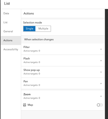

However, I believe that the answer is "this can be done from the actions tab":
JenniferAcunto

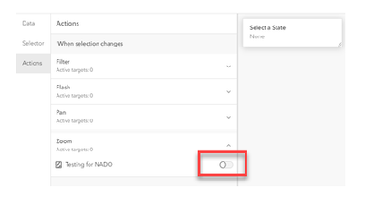

You do have the option, you just need to toggle it on. The action points to your overall map, because it zooms the map not individual layers.

Thanks for the reply. When I enable the Zoom function on the Testing for Nado map, it zooms to the middle of the Atlantic Ocean and not the selected state or county. I would like to see the individual layers listed in the Zoom option (i.e. State and County). These fields are captured in the survey. I am using the same state & county hosted feature layer in my survey and web map. I don't know when they are not available in the Zoom option.

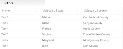

Survey123/Feature Layer Data

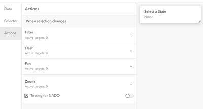

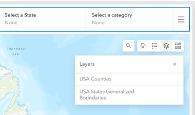

Dashboard selectors:

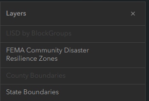

Web Map layers:
Am I doing something wrong that these web map layers are not available under the Zoom option for the state and county selectors?
