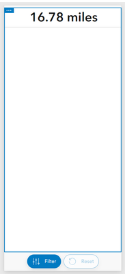

We're looking to embed our ArcGIS Dashboard into a third-party product and would like to force the embed as the dashboard's mobile view. Currently when embedding with just the URL it results in a very "squished" dashboard:
Therefore we would like to use the mobile view that we created:
Is there a way through url parameters to force the dashboard into the mobile view? Example for how the WAB team did it: https://doc.arcgis.com/en/web-appbuilder/latest/manage-apps/app-url-parameters.htm#:~:text=html%3Flo...

This is exactly what I was looking for! Gah sorry I missed this.
Fyi for everyone else on this thread, the format for the parameter is
#view=mobile not the traditional url param ?view=mobile
