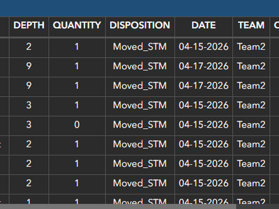

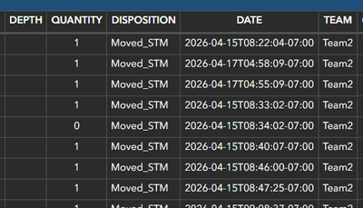

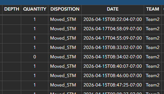

Hello.  I'm using advanced formatting on a table in dashboard and the domain code is showing from my hosted feature layer rather than the displayed value.
When I set the variable for each code the data disappears all together...am i missing something here or is this a bug?
Any assistance would be greatly appreciated!

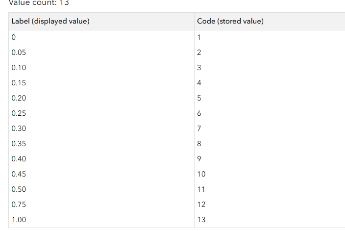

andeb31
When advanced formatting is enabled, the domain code stops being resolved and instead outputs the raw stored value (annoying). Try this:
var depthLabel = DomainName($datapoint, "Depth")
Depth: {
displayText : depthLabel,
textColor: '',
backgroundColor: highlight,
textAlign: 'center',
iconName: '',
iconAlign: '',
iconColor: '',
iconOutlineColor: ''
That should force using the domain name or value instead of the code.

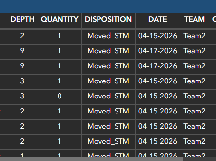

LindsayLewin
Magic...it worked.
Thanks so much for the learning.
