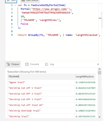

There it is! You can see it in the URL:
sublayer=10
Change that to a 10 and it works!
- Josh Carlson
Kendall County GIS
ZacStanleyNPS
Right! It's a feature set! TY!
