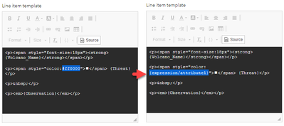

Just add your fields to the line template w/o the arcade fields. Then use the rich text editor to add generic color to your fonts, then open the source field and swap out the hex code for your arcade attribute in the HTML.

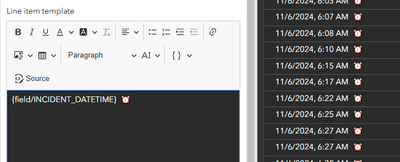

Just add the emoji in the line item template next to your field: {field/date_and_time} :alarm_clock:
- Jen

You will want to return all three arcade variables as attributes, and then plug those attributes directly into the HTML of the Line Item Template. Scroll down to the Arcade Attributes section of this blog post for a step by step explanation.
As far as a clock icon, the easiest thing would be to use a clock emoji :alarm_clock:. Emojis are great because they are essentially just text and you can add them just like you would any other text in the list. Otherwise, you would need to use an SVG code and some HTML.

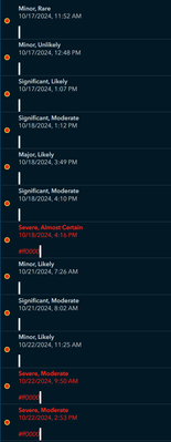

Good morning Jennifer, hope all is well and thank you for the quick response so I try doing what you did in the blog, but as you can see i am still not there. Can you please help further with this?
Also, how and where exactly should i put the emoji text in the Arcade expression and HTML?

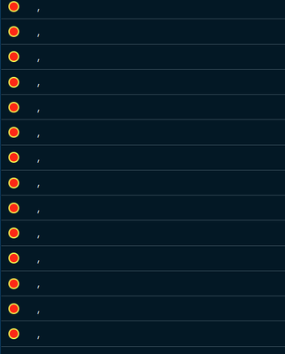

@JenniferAcunto I also tried the following but it's still the same
<p><span style="color:{expression/attribute1}"> </span> {how_severe_could_the_injury_to}</p>
<p><span style="color:{expression/attribute2}"> </span> {what_is_the_probability_that_in}</p>
Current output:

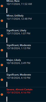

Hi Jennifer, thank you so I did that but now the output is showing the hexcode in red

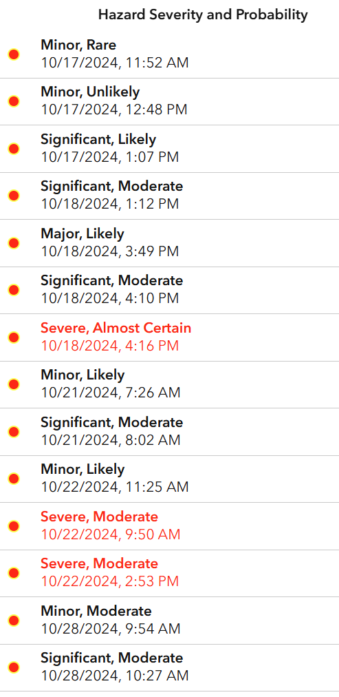

Ed_
by MVP Regular Contributor
Hi Jen, thank you for the quick response but it's still not working
