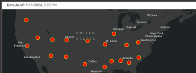

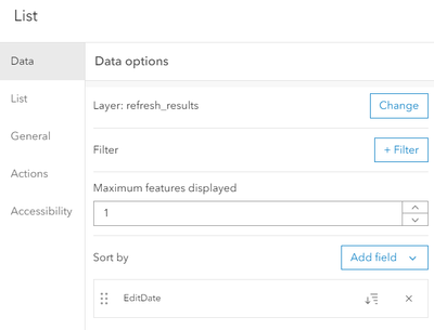

You can't. The Item info is only for the Dashboard itself. What I typically do, is add a List element using the data I want to display the date for. I set the maximum features displayed to 1 and sort descending on the Edit Date in my data.
Then I style the list as if it is a rich text element using that edit date field.
