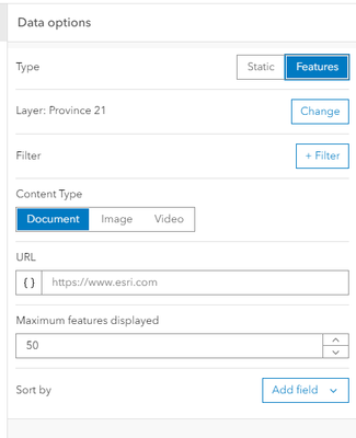

You need to set your embed as a feature and select the layer that drives it and not add it as a static embed.

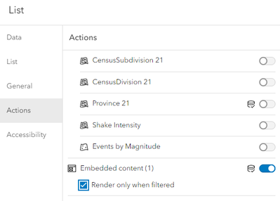

Embed Widget:
List Widget:
Embed Widget:
List Widget:

sandra555
Thanks Jen for your post with the screenshots - those were really helpful for me.
For others struggling to get this to work, for me, the form of the URL was different then noted above, it was like this: https://www.arcgis.com/apps/dashboards/32d0fdf612b440a3ttt9437077693e02#site_no={field/site_no}
Where the first site_no is the name of my URL setup in my embedded content and the {field/site_no} is the field in my main dashboard that is changing.
