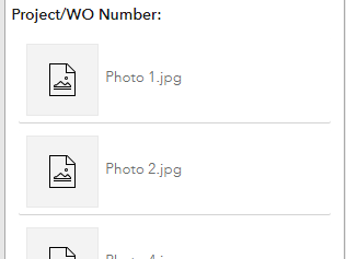

Using Details you can show attachments.  In the previous Dashboard it looks like this
In the current dashboard that is the new option it now looks like this.
