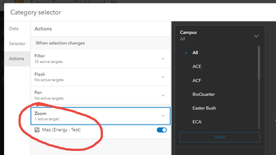

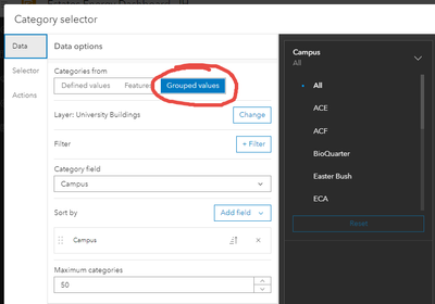

Hi @JoseQuintana, this works fine for me.  I have a Category Selector based on Grouped Values:
And in the Actions section I can now specify the map zooms to the grouped features:
It works really well and is a big improvement.  Hope this helps.
