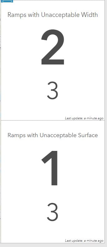

Here's what some of my indicators looked like beforehand:

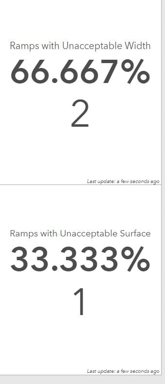

These compared the number of unacceptable ramps to the total ramps underneath. It could have been made more clear by adding more text, but it still wouldn't have been as intuitive as the percentages we're used to seeing. Here's what it looks like with a percentage:
Much more intuitive! No the percent is displayed clearly, and the number of assets that are unacceptable is displayed below for context. This is much more intuitive, and since the total number of ramps is displayed elsewhere on the dashboard, it's less repetitive.

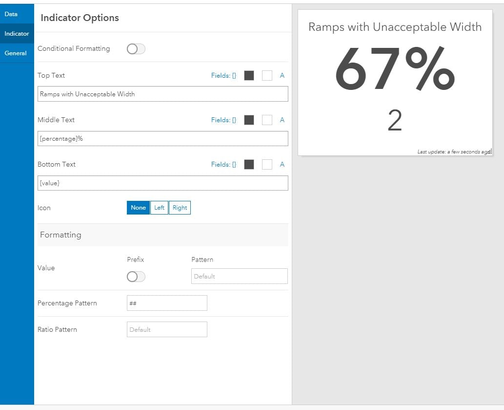

Great, but why so many decimals? That's the default, but you can easily format to get rid of the decimals. Here's what that setting looks like:
You can find more on number formatting here: Format numbers—Operations Dashboard for ArcGIS | ArcGIS.
