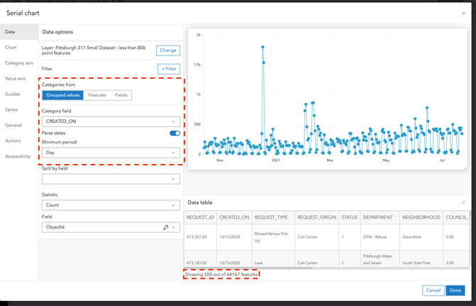

For example, in my screenshot below, I am aggregating service request entries from my layer based on a date field and have set the "Minimum period" to "Day". This means that each data point on the chart represents an aggregation of the total number of requests submitted per day
Notice in the data table preview that the underlying layer, in fact, has 64,167 rows. That's OK because the chart itself has aggregated those entries for each calendar day and the chart isn't trying to show 10,000+ unique calendar days. The chart should continue to aggregate and display all grouped values correctly and you will not see any warning messages regarding data limits.

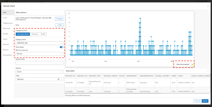

Using the same service request layer, I have configured another serial chart, setting "Minimum period" to "Minute". This means that each data point on the chart represents an aggregation of the total number of requests submitted per minute
As you can see in the screenshot below, now the chart has exceeded the 10,000 limit in an effort to aggregate entries spanning close to a year's time into individual calendar minutes. In this case, the chart will return and display up to 10,000 data points (or minutes) and display a "Data limit exceeded" warning message.

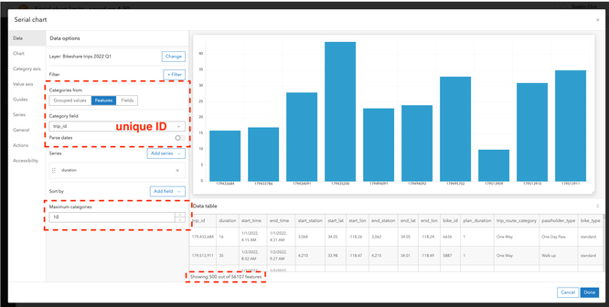

The same applies for "Features" charts. Now, rather than aggregating your data, a feature-based serial chart will display one data point per entry or row in your layer. In the screenshot below, I have a serial chart where I am visualizing the trip duration for each "trip_id", which is a unique ID assigned to every recorded bike trip. The layer contains 56,107 trips, but I've set the chart to only return 10 categories using "Maximum categories". As you can see, the chart will render according to configuration.

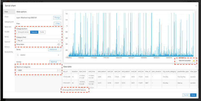

Now, say you want to show the trip duration on more than 10,000 bike trips all at once. Notice that I have raised the "Maximum categories" to 10,001 to trigger the chart limit. The chart also displays a "Data limit exceeded" warning message as a result.

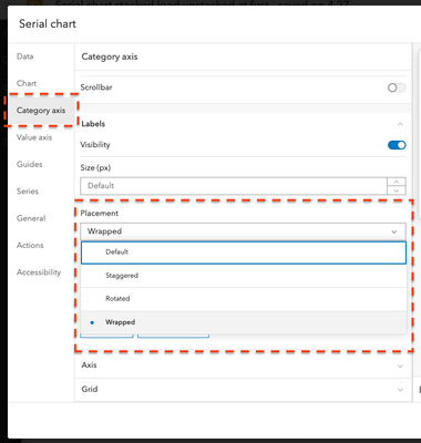

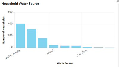

what is the solution to ensure that all labels appear?
LouisaM
@Soobin-Choi
what is the solution to having all labels appear?
Soobin-Choi
Hi @LouisaM! I would suggest trying the "Wrapped" category label placement option -
