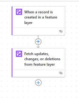

This is brutal. My flow stopped triggering when new records are created. This is the start of a lot of things for staff to do and track. Now it is dead in the tracks. Has been running perfectly for 6 months. The connection is valid.
I can push data back and update records in the same layer no problem. It is just not triggering on record creation. I saw someone posted on Monday something similar.
ESRI, anything going on we should know about.
I have saved the flow as, deleted trigger, readded trigger - nothing.
I have created a new flow with just those two steps and no trigger.

Tim, that is something to investigate then. What version of Enterprise are you using? Also, for layers to be used in PA, Editor tracking must be enabled. Check with your IT if any firewalls or requests are being blocked. (it is unlikely if you had this working before and nothing has changed)
There are a few steps to follow but this should help you in the long run to troubleshooting web hooks in general. To isolate the problem we can create a web hook outside of Power automate and ArcGIS. This will help us see if the webhook works. You can quickly create a webhook URL using this or similar sites  https://webhook.site/ . This is a great tool to test webhooks and some other things in general. All you need is
  • Create a webhook URL here in webhook.site and copy it.
  • Navigate to :/server/admin/services/hosted/<layer>/webhooks/create
  • Use the copied url as a "hook url"
  • Changes to listen to could be `FeaturesCreated` or `*` to listen to all changes.
  • Make sure to choose webhook is set to `Active`
Once the webhook is created you should see the response on webhook.site
  • Do updates/ create features (depending on what changes you are listening to) in your layer to see the updates in webhook.site feed
This feed should return the "ChangesURL".  This can be opened by first decoding then adding token at the end "&token=<token>". Token can be generated at the generatetoken endpoint or can be intercepted from one of the requests sent from portal using dev tools.  Once opened you should see the status URL at the bottom of the page which you can click to if the job is completed. If the job is completed then the status URL should show link to "json" file which can be downloaded and checked for the relevant record you updated.

I got lost a little bit lost on the rest. Made the webhook.site, created the new webhook, showed in webhook.site. Created new features and nothing happened.
