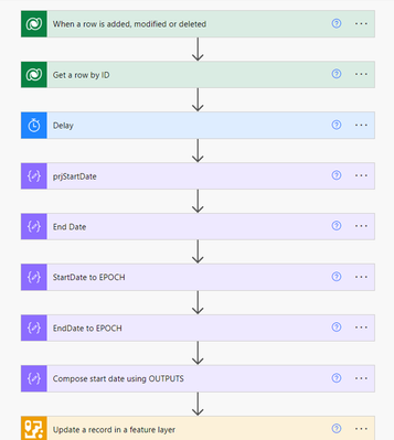

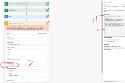

I have a flow in Power Automate that pull data from a Dataverse table, and update a hosted feature layer on AGOL. Everything seems to be working fine EXCEPT for my Date fields.

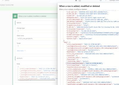

below is what is the payload form Dataverse

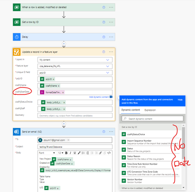

the 4th line has the data I am looking for to update my date field in AGOL. below is the error I am getting

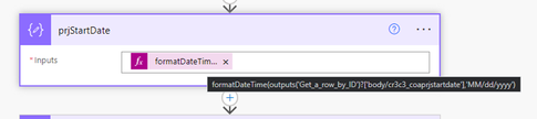

I have tried adding aFormatDateExpression (FormatDateTime(outputs('Get_a_row_by_ID')?['body/cr3c3_coaprjstartdate'],'MM-dd-yyyy')) but still no success.
Any help would be much appreciated.

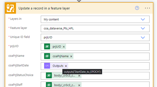

I solved the problem. I had to convert the INPUT date value to EPOCH using the following expression
div(sub(ticks(outputs('Get_a_row_by_ID')?['body/cr3c3_coaprjenddate']),ticks('1970-01-01Z00:00:00')),10000)

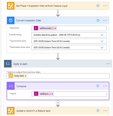

The initial trigger of this flow is a Survey123 submission. When certain criteria are met, then I get the matching parent record from a feature layer and convert the inspection date from the Survey123 form. Syntax for this conversion is working well: addSeconds('1970-1-1', Div(triggerBody()?['feature']?['attributes']?['INSPEC_DATE'], 1000), 'yyyy/MM/ddTHH:mm:ss')
I then use Compose to addDays to my converted dateTime. I am getting the interval from my feature layer. Again, this is workign well: addDays(body('Convert_Inspection_Date'),int(items('Apply_to_each')?['Attributes/PHASE_I_INTERVAL']),'yyyy/MM/ddTHH:mm:ss')
I was initially trying to write the outputs from Compose directly to my date attribute field in the bottom "update a record in a feature layer", however I am getting an error when I try this. I stumbled across this post and I think the conversion back to Epoch time is exactly what I need, but can't get it to implement. Here is what I am trying: div(sub(ticks(outputs('Compose')?['body/Compose']),ticks('1970-01-01Z00:00:00')),10000)

I think you might be missing something in your first expression (you are not referring the attribute section). In your case it's probably: Body/data/attributes/FIELDNAME
below is a sample of a breakdown
below is another example I have:
hope this help (and not confuse you more  😁)
erica_poisson

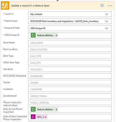

@DominicRobergeIADOT  that was so helpful! Thank you for those detailed images and also your patience with me! Here was what I ended up doing:
div(sub(ticks(addDays(body('Convert_Inspection_Date'),int(items('Apply_to_each')?['Attributes/PHASE_I_INTERVAL']),'yyyy/MM/ddTHH:mm:ss')),ticks('1970-01-01Z00:00:00')),10000)
Instead of adding a second Compose, I just updated my original Compose which was using the "addDays" function and nested that inside your EPOCH conversion. The I used outputs from Compose within my ArcGIS "Update a record in a feature layer". It worked perfectly when I tested!
