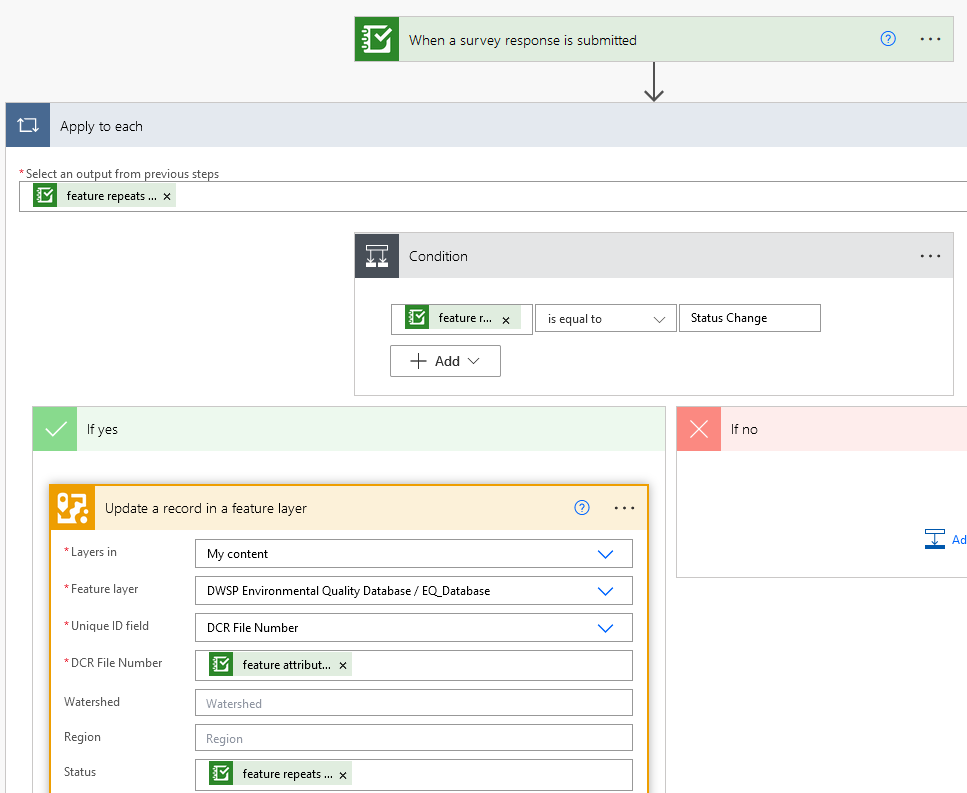

I am building a new Flow to update a feature layer based on the updates to a related table. The data is updated through Survey123, so I am using the Survey123 trigger in conjunction with the new ArcGIS Connector to "Update a record in a feature layer".
I've set my condition so that the update only occurs when Update Type = Status Change, however I can not figure out how to only look at the most recently submitted related record. While this Flow is working well and my feature layer is being properly updated, I can't help but think there is a better way to do this... I just don't know what that way is.
What I'd like to do is have the Flow only look at the most recently submitted related record via the Survey123 trigger. What is actually happening is that every related record is being assessed and the feature layer is being updated multiple times.
Any suggestions would be helpful. Below is my current configuration:
Erica

2. So, would I modify my Flow so that I first have the ArcGIS Connector "Get data from feature layer", right after the Survey123 trigger? Is there where I could use the Where clause to set up this query? I am not really sure if I understand how to inspect the dates for all related records within the context of these new connectors. If you have additional steps/details or even a sample Flow or workflow I could look at, that would be massively helpful.
