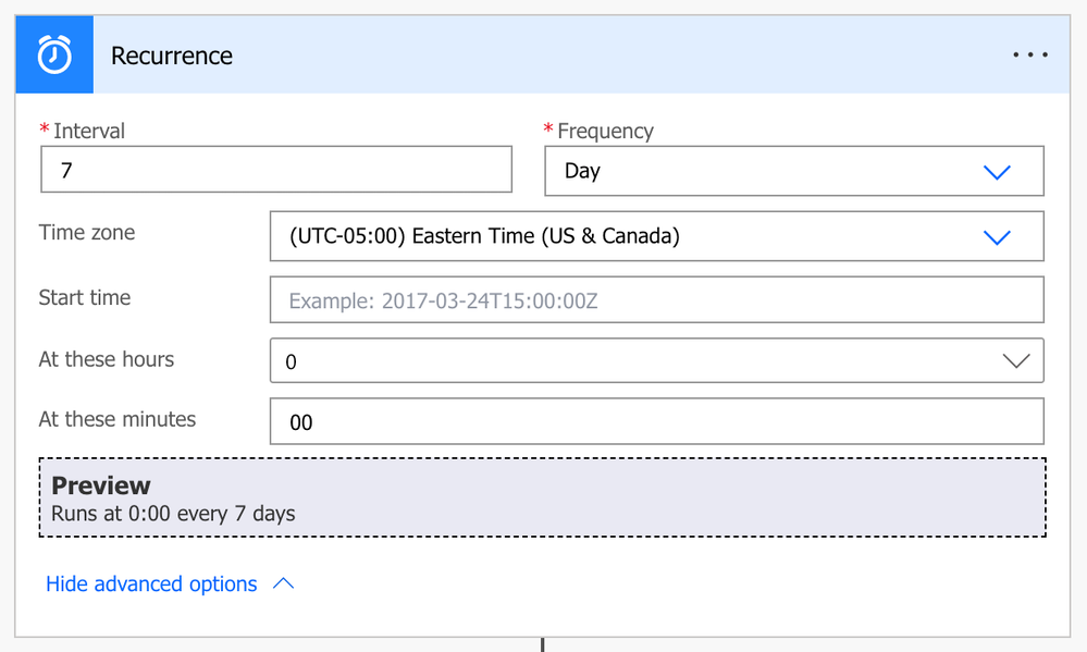

Recurrence Trigger
In order to get the flow to run at my desired interval, use the Recurrence trigger. It will allow you to set up the desired frequency and when you want the flow to run.

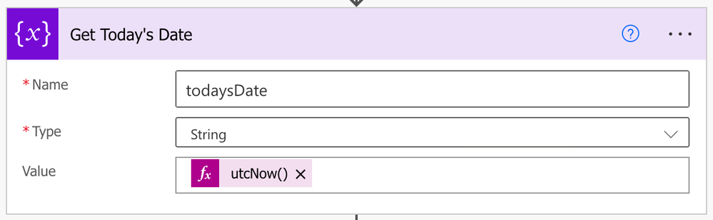

Get Today's Date
The next step is to get the date the flow runs - to do this, I am going to initialize a variable to represent today's date and set the value with the utcNow expression.
utcNow()

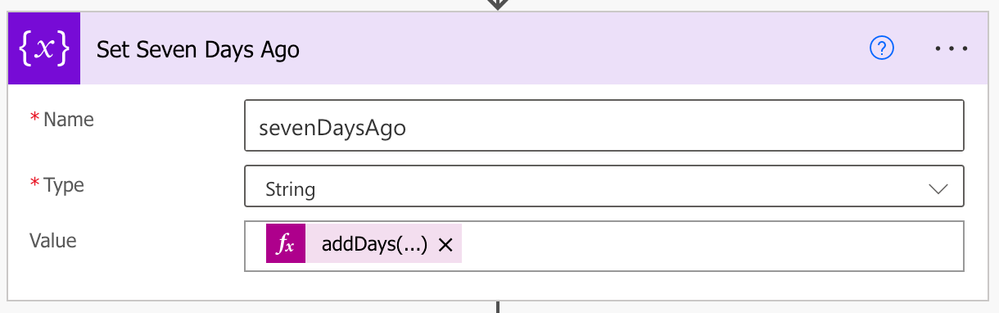

Seven Days Ago?
Now that we have the date the flow is running, the flow will need to figure out what the date was seven days ago. I will create another variable to calculate what the date was seven days ago. I will use another expression to calculate the value:
addDays(variables('todaysDate'),-7)
The 'addDays' expression will use the 'todaysDate' variable we created in the previous action and subtract seven days from it.
NOTE: The previous two steps can be combined into a single action, for simplicity's sake I broke it into two actions.

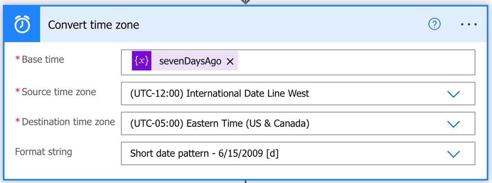

Optional Step - Time Zone Conversion
If you are looking to query for a time in a local time zone, the Convert Time Zone action will give the flexibility to convert to any time zone. In the screenshot below, I am converting the 'sevenDaysAgo' variable from UTC to Eastern Time.

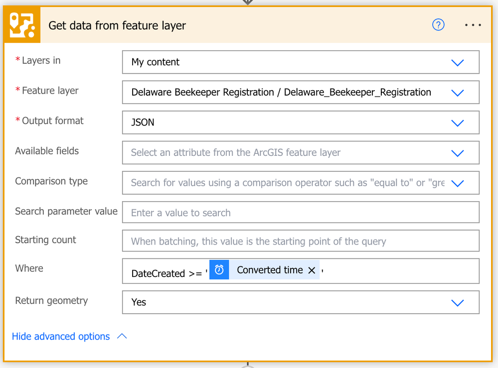

Query for Records Created in the Past Week
Now that we have the start date, we can get all of the records that have been created during the desired time range. The 'Get data from feature layer' action will query the feature layer for us filtered by the desired date range.
NOTE: Notice the single quotes on either side of the Converted time dynamic content. The query is expecting a string wrapped in single quotes.
The action will return all of the records that meet your query as JSON which will the flow to iterate through each of the records - including the ObjectIDs to create the reports.

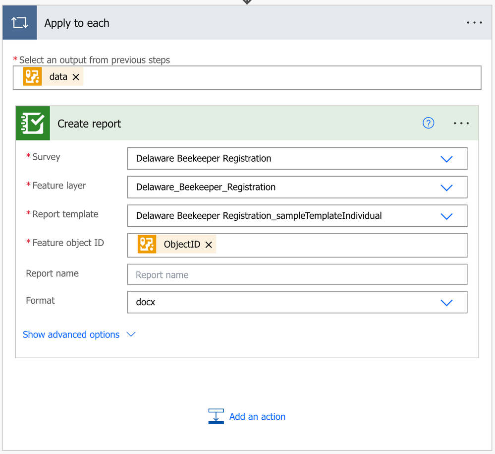

Iterate Through Results and Create Report
To get the ObjectIDs, we need to iterate through all of the data returned from the query with the 'Apply to each action. This will give the flow access to each record that met the query parameters.
Now you will be able to access the output from the 'Create report' action and build out the rest of your .

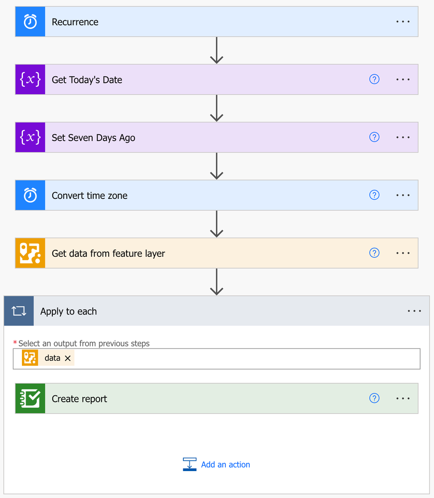

This is what the whole flow will look like when implemented as laid out in this post.This is what the whole flow will look like when implemented as laid out in this post.
