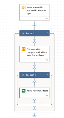

AFackler_NAPSG
Thanks for your response @RobertAnderson3! I have tried setting up the When a record is updated in a feature layer trigger with the Fetch updates, changes, or deletions from feature layer action, but because all the editing is done on view layers and the master feature class is private, setting this up on the hosted feature layer doesn't work. I attached a screenshot of my workflow below - basically, all I'm doing is adding that feature's attributes to a table any time an update happens. The issue is when points are marked as deleted, they leave the main view and go into a different view, so the change is not logged. Both the When a record is updated in a feature layer trigger and the Fetch updates, changes, or deletions from feature layer action are both tied to the editable view layer.
