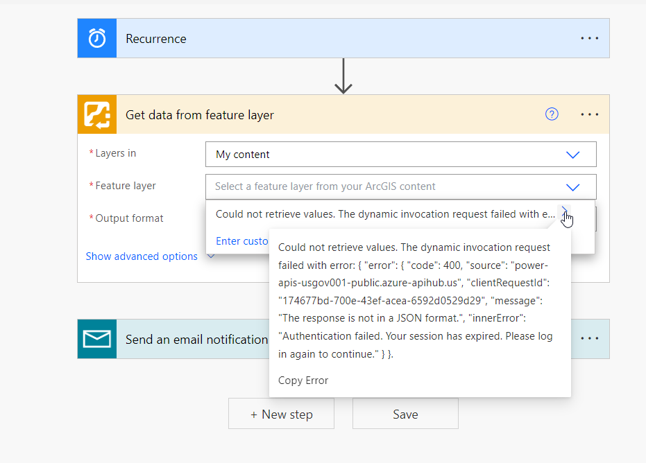

I am trying to create a flow that gets data from an existing AGOL feature layer. When I add the action to my flow, I am getting the below error. I have tried entering in the itemID and using different actions from the list of ArcGIS actions and get the same error with each.
(Could not retrieve values. The dynamic invocation request failed with error: {
"error": {
"code": 400,
"source": "power-apis-usgov001-public.azure-apihub.us",
"clientRequestId": "174677bd-700e-43ef-acea-6592d0529d29",
"message": "The response is not in a JSON format.",
"innerError": "Authentication failed. Your session has expired. Please log in again to continue."

I am having the same issue and see that there is a bug logged: https://support.esri.com/en-us/bug/authentication-to-arcgis-online-through-arcgis-connecto-bug-00016...
Discussion on this post suggests refreshing the connections. That worked for me, but who knows how long it will last

I have this error. I check the connector and it says it is signed in already. It works for awhile but now when I make a request I get this error out if nowwhere, like after a few hours.
If I go into my connectors and hit edit on the three dots, for the enterprise connector, it seems to reconnect. Don't know how to keep it connected yet. It won't reconnect.
