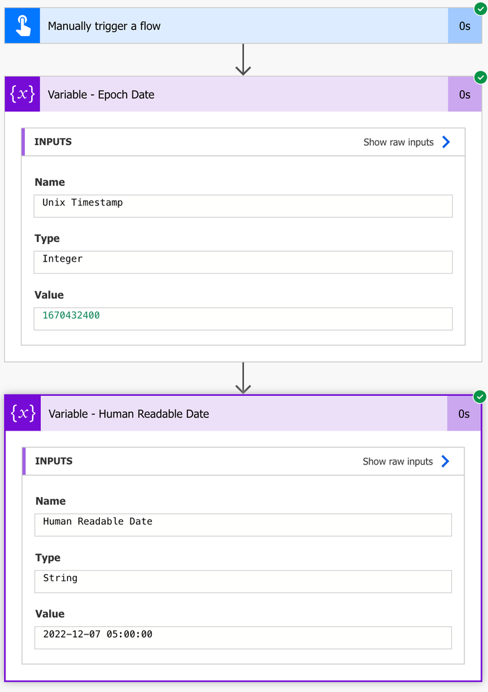

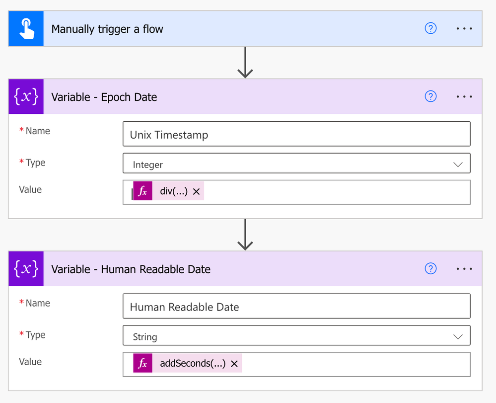

I walked through the steps to convert the value you shared, 1670432400000, and converted it into the value are looking for with the following flow.
In the 'Variable - Epoch Date' initialization, the expression is:
div(1670432400000, 1000)
 In the 'Variable - Human Readable Date' initialization, the expression is:
addSeconds('1970-1-1',variables('Unix Timestamp'), 'yyyy-MM-dd hh:mm:ss')
After testing the flow, here are the values:

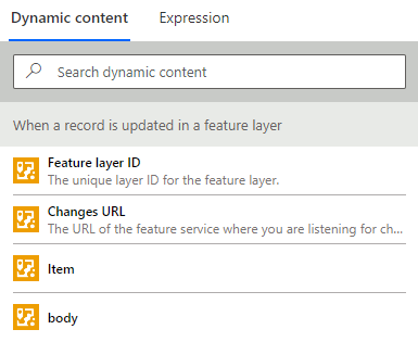

Because I don't have my fields available as an option to input for the value in the initial variable where I currently have it lined up. These are the only dynamic content options I have

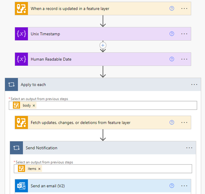

And if I try to put the variable in after the "Fetch updates..." I get an error saying that I can't set a variable that late in the flow.

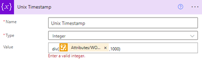

I copy/pasted the date field into the first initialize variable value question, and tried to save the flow, and it won't let me, says it's an invalid integer.

You cannot initialize a variable that late in the flow, but you can use the 'Set Variable' action to to set the variable's value as your 'Send Notification' iterator goes through each of the records in the webhooks payload from the 'Fetch Updates' action.
